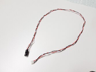

Communication interfaces
The following interfaces are supported:
  • Single or doubly-redundant CAN bus – UAVCAN. The UAVCAN GUI Tool might come in handy. The implementation of UAVCAN in Myxa is largely equivalent to that in Sapog, so please refer to the Sapog Reference Manual for an in-depth description. The only major difference is that Myxa does not support automated ESC index assignment - it has to be configured manually.
  • Proprietary binary serial protocol over USB and UART. The protocol is built on top of Popcop; it features a strong data integrity protection and resilience to packet losses. This protocol is leveraged by the Kucher GUI tool; as Kucher is open source, you are encouraged to use it as an example and reference for building your own applications that interact with Myxa.
  • The industry-standard RCPWM, sometimes referred to as RC PWM or even RC PPM. This interface is flawed in many ways, so we generally discourage its use. Shall you choose to use it, you will need an adapter cable (shown below) that connects the pin GPIO1 of the Aux connector on Myxa to an RCPWM-compatible header as shown below.
Integration instructions for Myxa are not yet written; however, we have them for Sapog, and seeing as Myxa’s communication interfaces are largely similar to those in Sapog, we suggest our early customers to refer to the following guides, keeping in mind the differences in configuration parameters, which we’re going to review here next: Knowledge base | Zubax Wiki.
