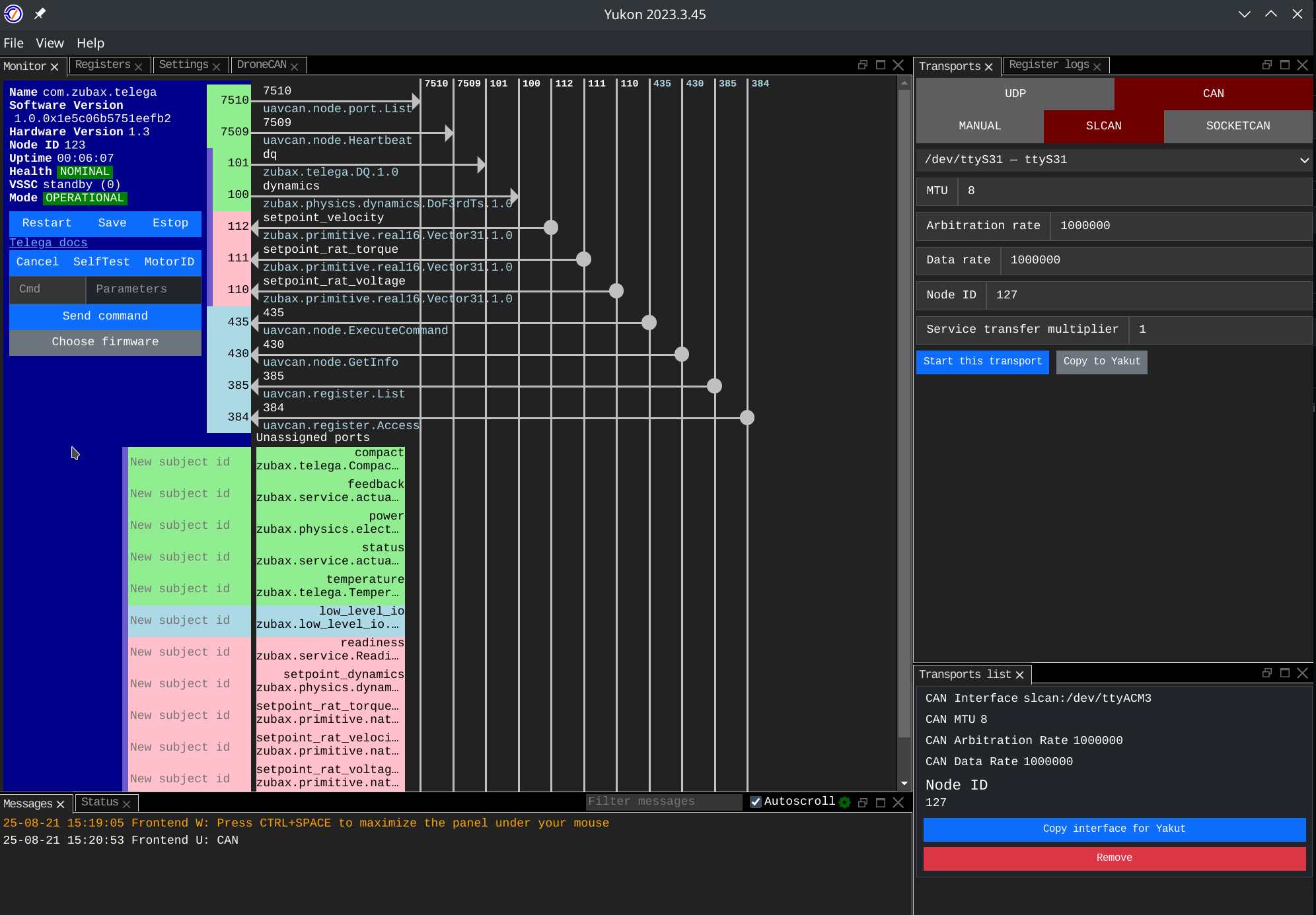

Start Yukon; in the Settings, find the firmware update section and ensure the path points to your downloads folder.
Select your CAN adapter in the Transports pane, then click “Start this transport”. Online Cyphal nodes, if any, will appear in the large Monitor panel.
Find the node you wish to update and click “Choose firmware”, then select the firmware file you downloaded in the first step. Repeat this step for all nodes that need updating.
