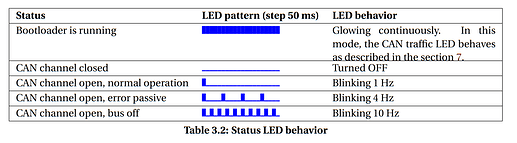

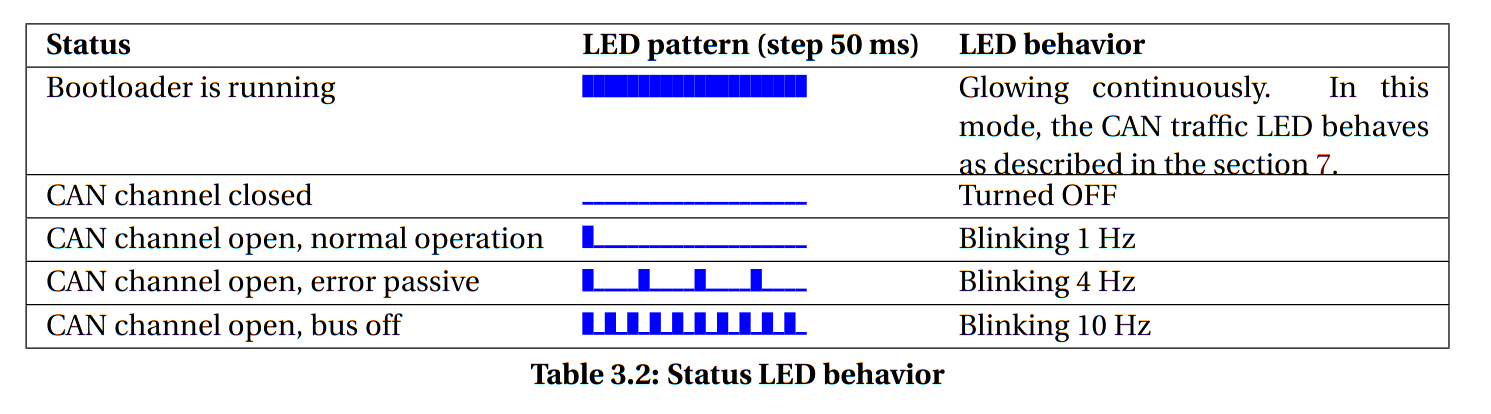

However, I am noticing in your video that the CF1 Babel is flashing the blue LED four times per second, indicating that it resides in the ERROR PASSIVE state, suggesting a CAN wiring or configuration problem. For context you can refer to https://files.zubax.com/products/com.zubax.babel/Zubax_Babel_Datasheet.pdf

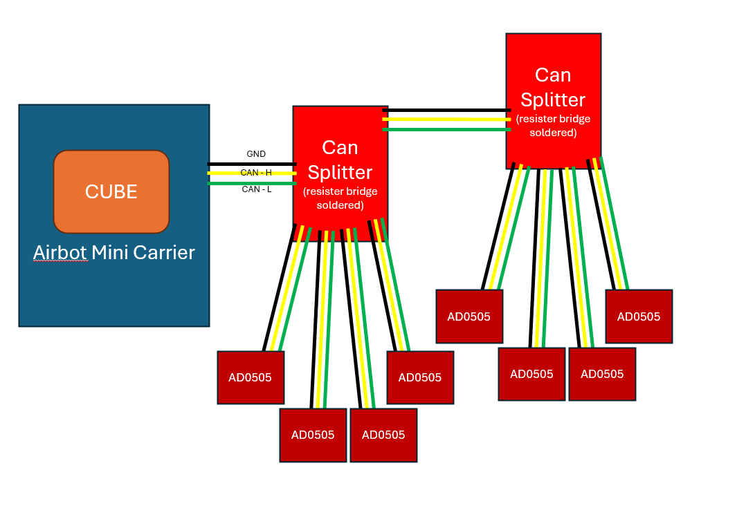

  • Please show me how exactly the CAN bus is wired, either on a schematic or with close-up photos.

See wiring diagram.
Im well aware this isn’t the perfect can network, but all wires are under 5-7cm from each splitter. The wires joining splitters are 20cm. All solder bridges are joined and when testing with a multimeter when connected to the carrier board i get 60ohms on the first splitter, and 120 ohms on the second when joined so the resisters across the network seem fine.

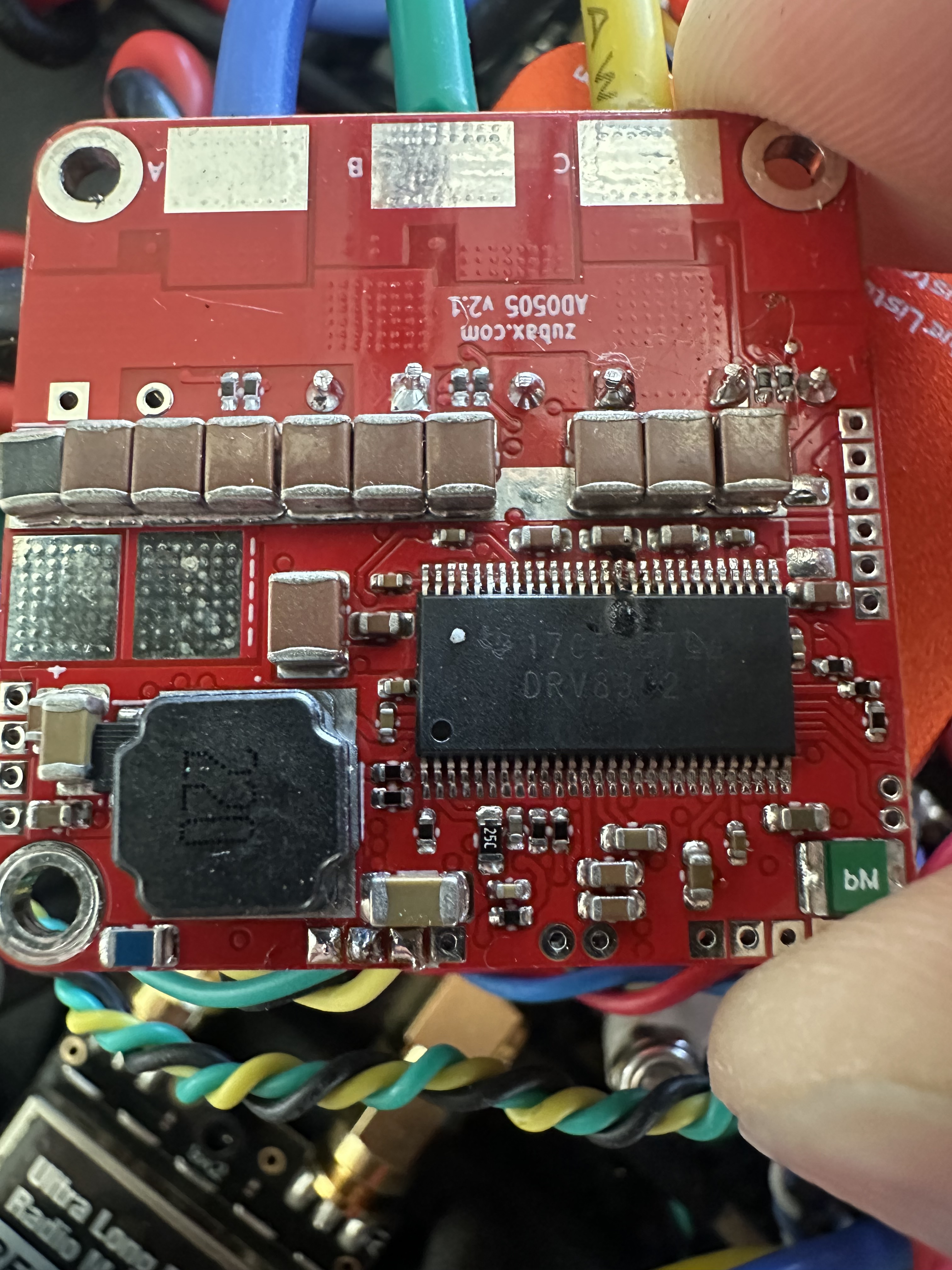

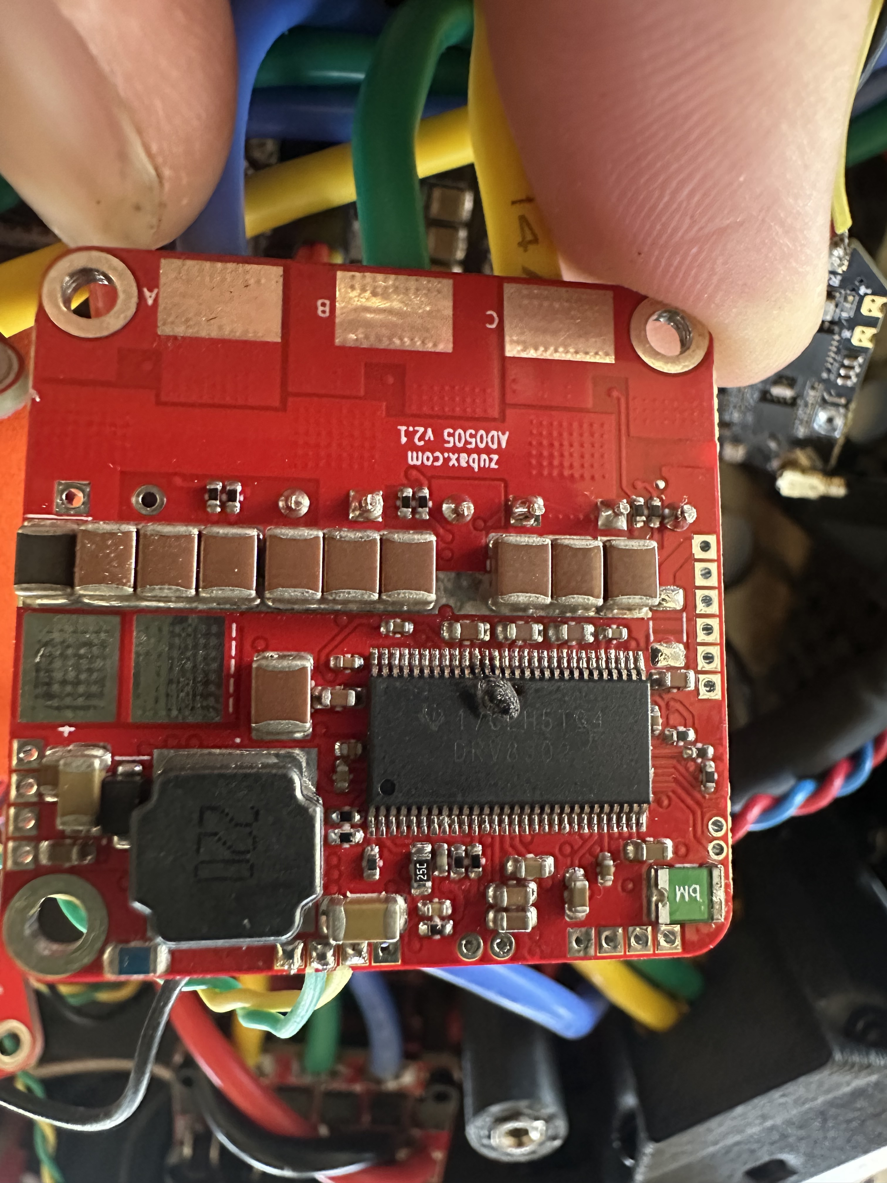

Failure!
Now after a motor test in Ardupilot I have had two similar failures in each modules. A Loud POP and smoke out of two.
see photos below, both failed in the exact same place. These are two seperate ESCs out of 8.
now I’m down to 5 out of 8 ESCs.

And Photos of the two that have failed.
