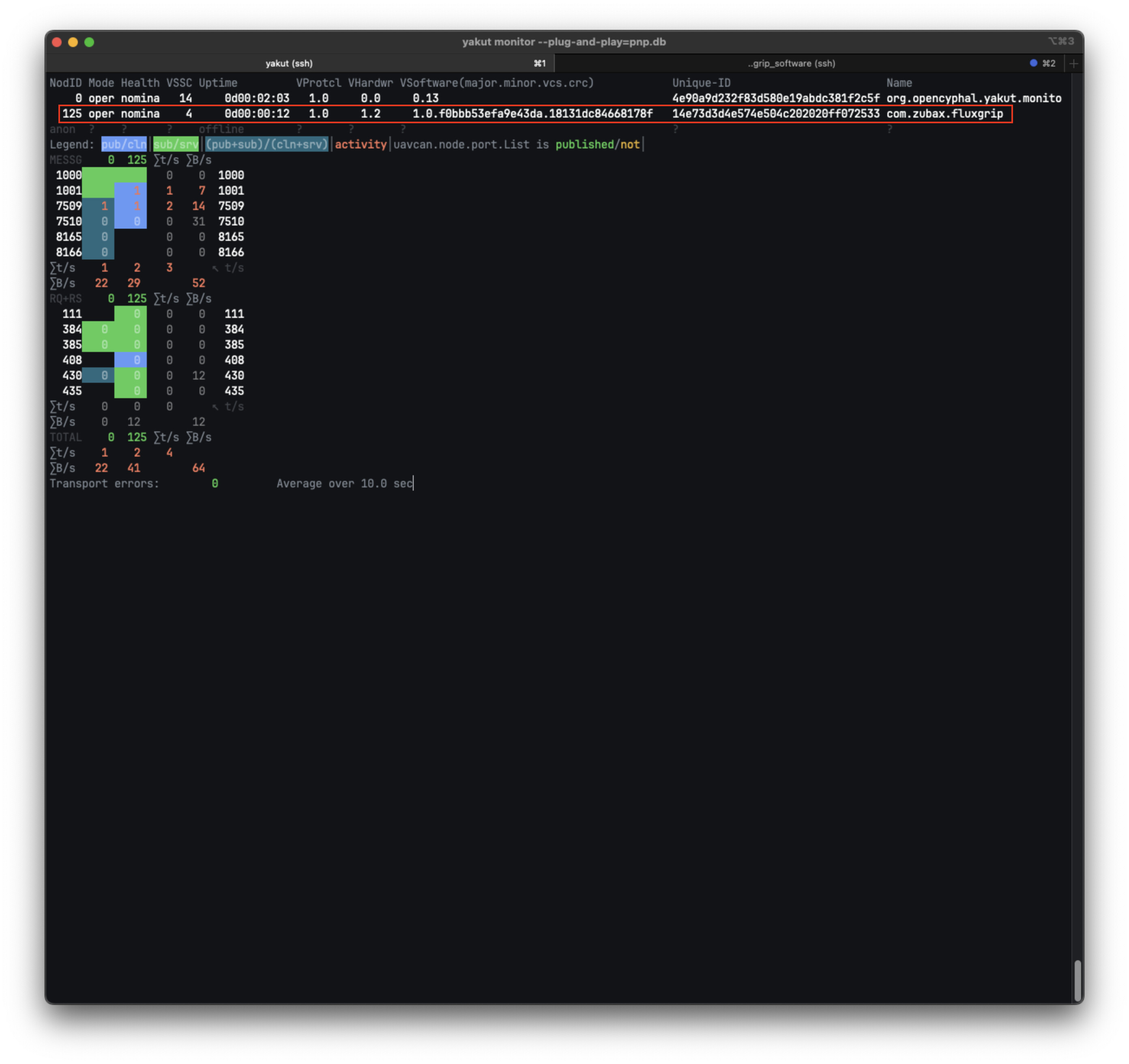

initially, it shows the states properly, but soon only output a table of 2 rows
2 rows is what you would expect (briefly a third row appears when issueing the command)
Copying from the (outdated) Quickstart Guide:
The subscriber receives the magnetization command briefly and went back to false state, afterwards, the magnets go back into fault state, showing a VSSC of 5.
