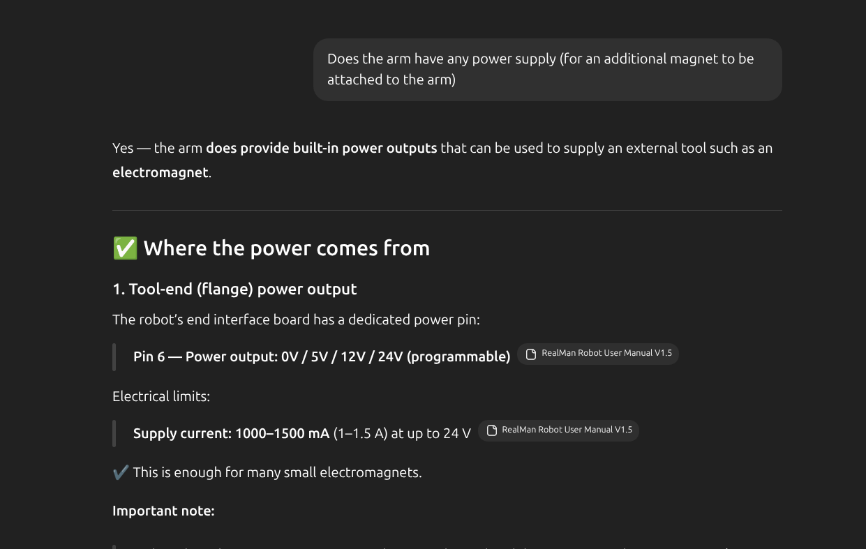

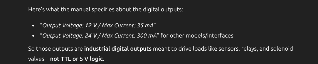

I asked ChatGPT about what kind of digital output this arm supports:

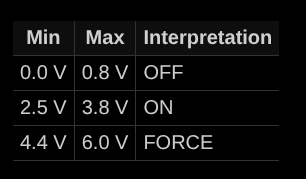

Given that we need something between 2.5 and 3.8 V for turning on the magnet:
Your best best will be to use a simple voltage divider circuit (resistors in series) to achieve the correct voltage for the control signal.
Regarding the power, this seems to be provided already:
(Sidenote: power requirements for FluxGrip can be found here)
