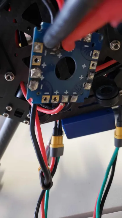

The params myxa have been reset to defaults aside from the ones needed to be changed for the specific motors. (I’ve uploaded the params of 2 myxas). They are powered by a PCB that is basically just 2 copper fills and some pads (not the prettiest but I think it gets the job done)
