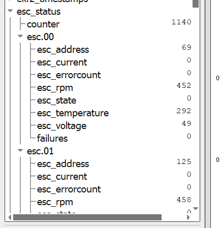

I have some logs from previous flights using the A0.
We used to have all of these readings, with full RPM and current readouts from the Myxas. I am mainly wondering why this is no longer in our logs. We will take a look at this subscriber for the driver but still wondering what changed since then.
