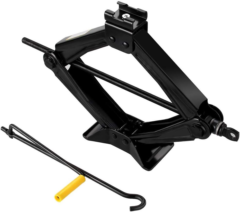

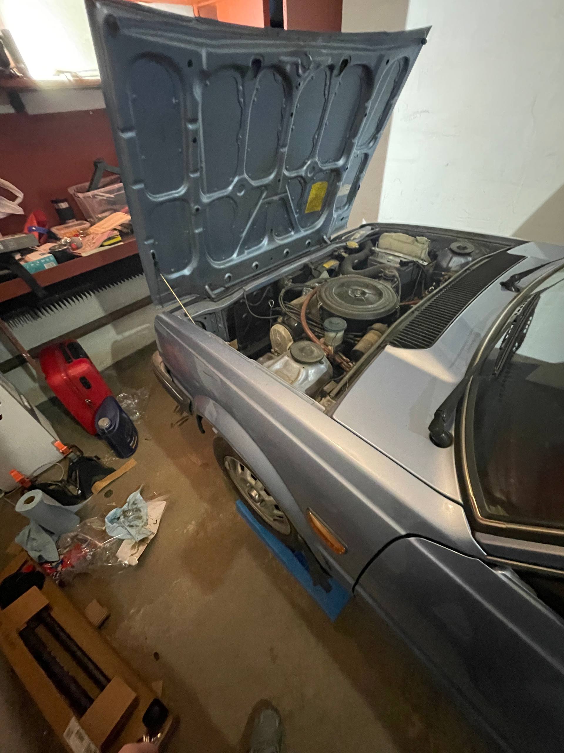

I lifted the car using the portable jack, it doesn’t lift high enough to be able to put in the jack stands, but we like to live on the edge, don’t we folks? It was enough for me to be able to reach the drain bolt. I put on my nitrile gloves, pulled the oil change canister underneath the car and started trying to unscrew it. It didn’t budge. Now I’m applying quite a bit of force: still nothing. By this time I was starting to get a little worried about my whole “living on the edge” schtik, you see: the car was standing on a single point of failure: the portable jack, but in combination with the sideways force I was applying to the engine to unscrew the drain plug, I was getting increasingly worried about what if it slipped. It’s good enough for changing a tire, but I didn’t want to seipuku myself by dropping a car on my head.
A couple months back I had watched a Youtube video on how to do an oil change, there the guy used these plastic on-ramps, so I decided to go looking for a pair in the local car parts store.
After getting back with my new car ramps, it was time for a second attempt at the drain bolt, this time with the edge being at a more comfortable distance. After struggling for another 10 minutes or so, I managed to unscrew it, and the oil started gushing out.
