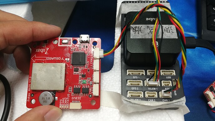

GNSS2 don’t work with arduplane 3.9.0
I have a problem.I am using UAVCAN to check GNSS2 that everything is normal.
The configuration of my mission planer is as follows.
I refer to the official guide link.
I used PIXHAWK2’s CAN2 for the link.
I took the controls outside and waited a long time. The GPS could not be fixed.
I am sure GNSS2 is good and the connection is correct. I suspect ArduPlane is not compatible.
I believe you are supposed to set the GPS type to 9. Or maybe not. I am not sure.
