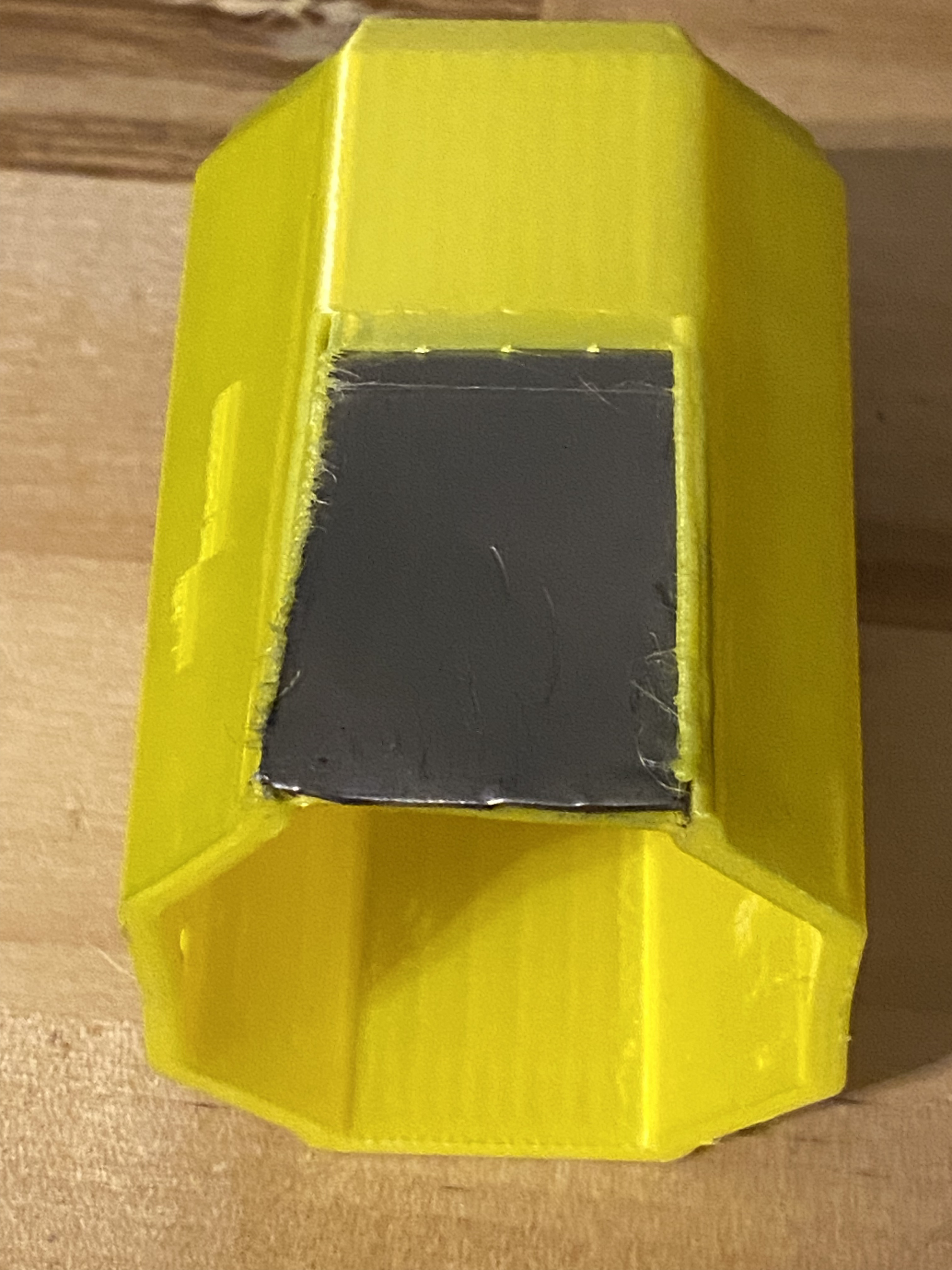

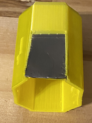

The sleeve to hold this airsoft grenade is made of 3d printed TPU and it has a small 22 GA steel insert:

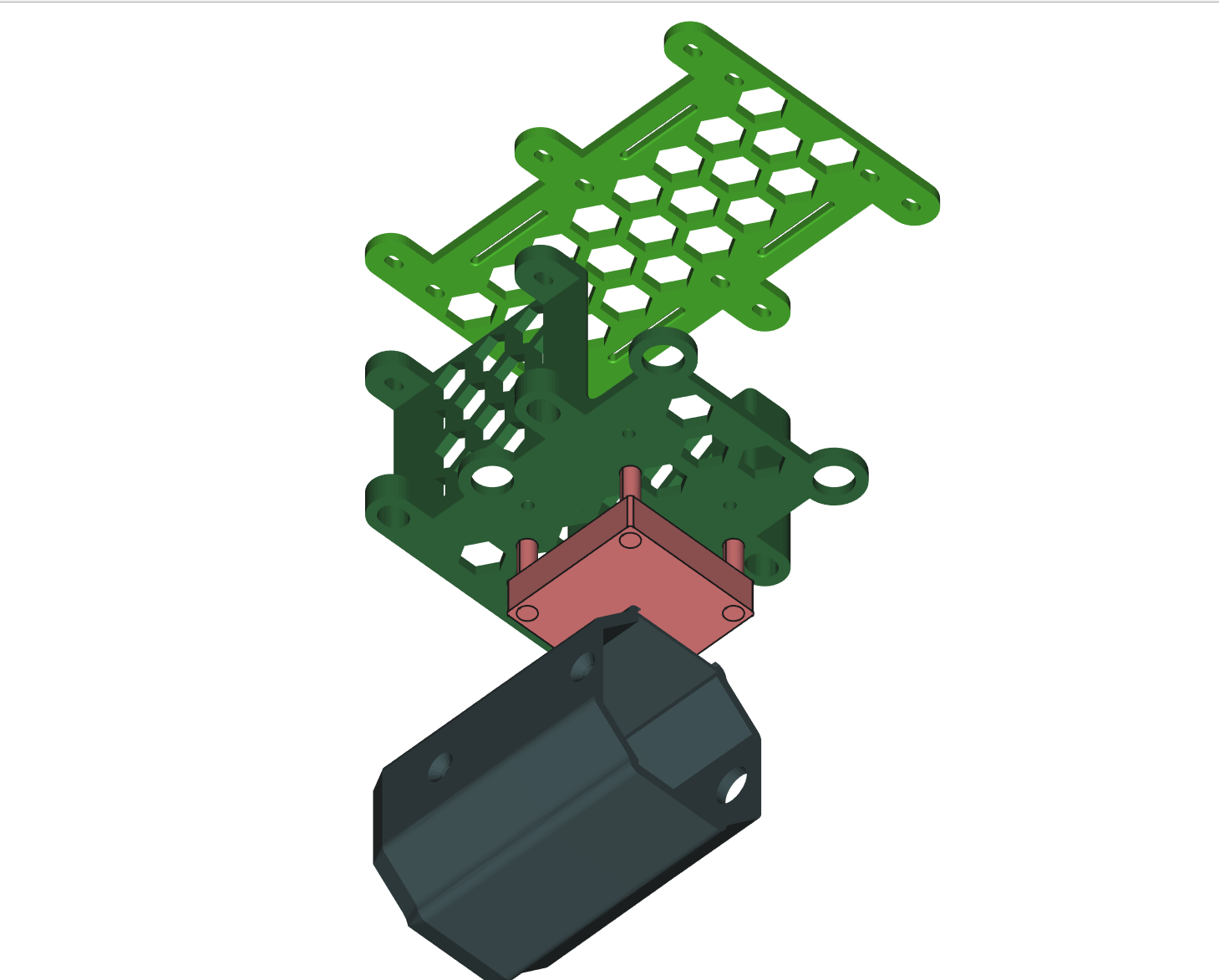

The Zubax FluxGrip interface to the drone frame is based off of a battery mount I found on thingiverse and modified to have mounting holes for the fluxgrip:

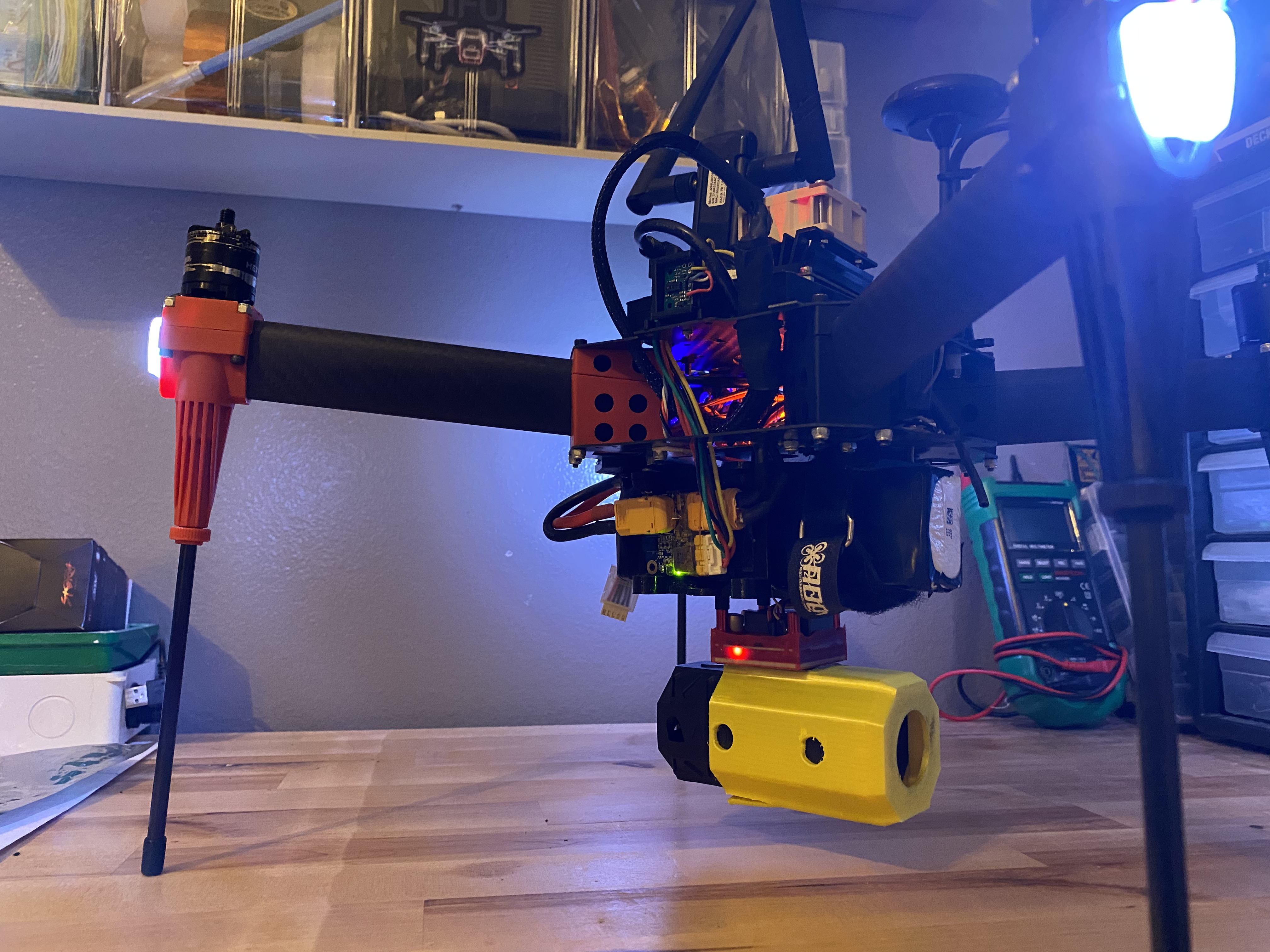

Mounting to the EDU 450 drone frame

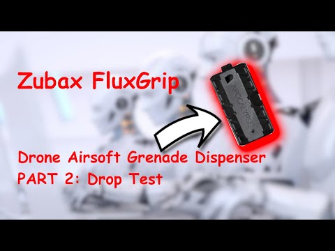

First ever drop test with the airsoft grenade was a success!
I first set COM_PREARM_MODE to 2 (always) so that the non flight actuators will be active even if the drone is disarmed. This prevents me from having to attach the grenade with the motors + props spinning
I went ahead and assigned the FluxGrip PWM channel to RC AUX1 port via the Control Allocation page. AUX1 is is mapped to my RC switch.
Alternatively, you can also assign the PWM channel as a gripper if using a joystick.
