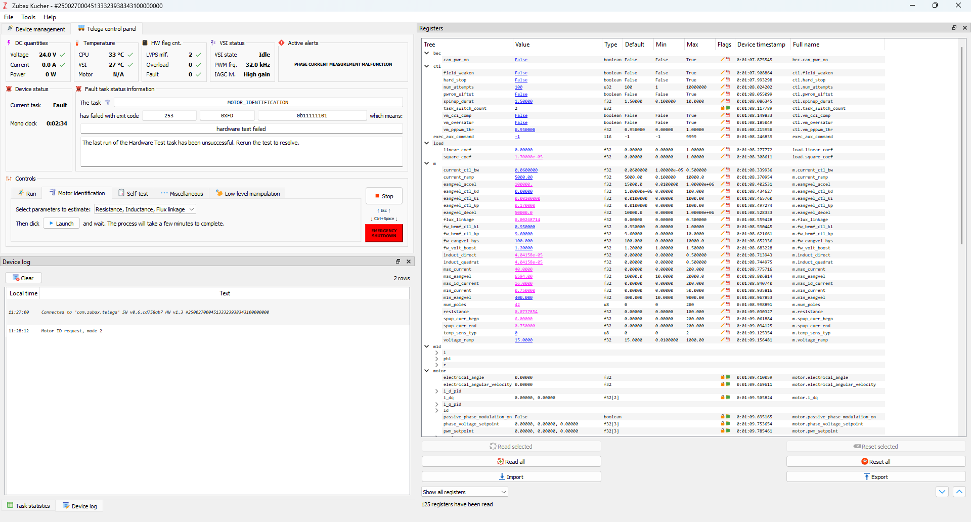

I now consistently get the following active alerts:
PHASE CURRENT MEASUREMENT MALFUNCTION

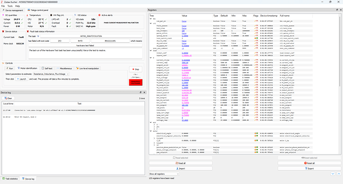

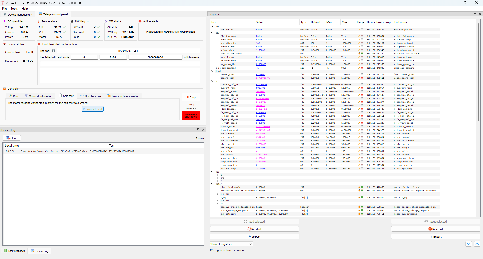

I have run a self-test and then tried a motor identification procedure (mode 2: Resistance, Inductance, Flux linkage), but that also fails with:
  • self-test
Status: Fault
Affected task: HARDWARE_TEST
Error code: 0x88 (0b10001000)
  • motor identification
hardware test failed
Task: MOTOR_IDENTIFICATION
Error code: 0xfd (0b11111101)

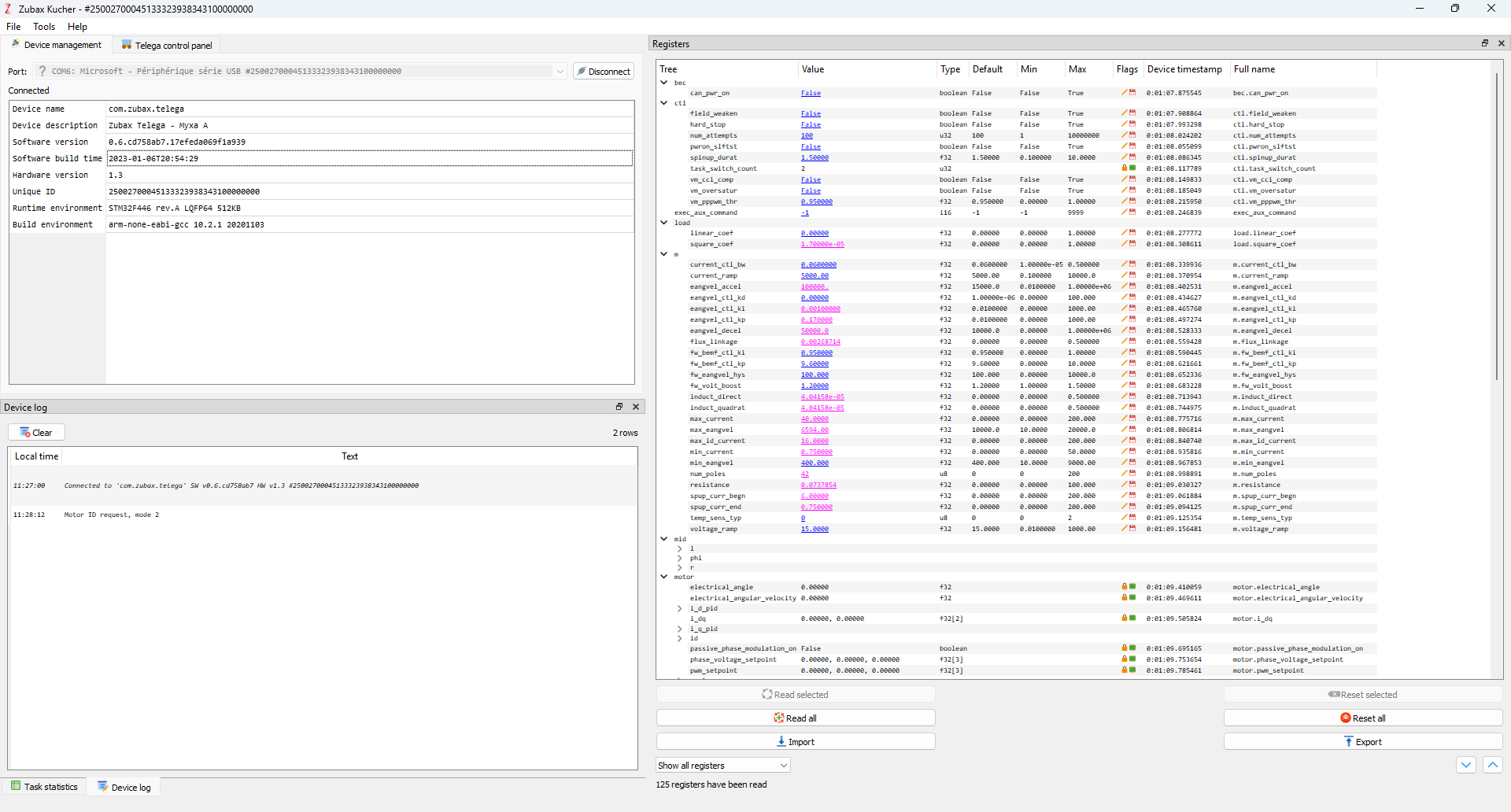

Additional details about the firmware version:
